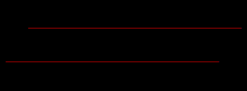

In this example we move a line by the displacement vector v = (2,3,0).
MoveGeometry -i line.gml -o moved_line.gml -x 2 -y 3 -z 0
Fig.1 Visualization of a line and the moved line viewed along the z-axis.
